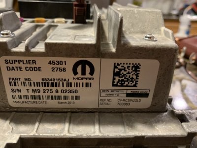

What is the part number on the back of your radio?

This is all I have without taking out the radio.
Here's the info...
CHRYSLER
Model : Uconnect 8.4 UCS
Part/Model : 68340153AJ
Manufacturer : PANASONIC
I haven't heard of a UCS before. I'm guessing maybe its a country specific UAS? Anyway, what was stated earlier is correct. IF this radio is capable of Android Auto and CarPlay, then you will also need to change your USB hub to a compatible version.

Here's the info...
CHRYSLER

Sounds like a defective radio. Try to get a US radio next time.
RADIO: 68331631AH (UAQ) or 68331635AH (UAS)
The last two letters are revisions so don't stress if the radio you are looking at has a different suffix.
EDIT: My mistake, I did see the OP was in Canada. If it is a Canadian spec truck try to find Canadian radio (UCQ, UCS). If it is a US spec truck, try to find a US radio (UAQ, UAS).

Yes, I would consider returning it if that's the case. I'm not familiar with the UCS but it says it's a Ram part from everything I see.
I'd feel more confident advising you if it were a UAQ or UAS, but these radios are too expensive to deal with problems like that right off the bat. Normally, after install and at least 2 hours of the radio settling in everything should work properly.

WHen you fin one from a salvager, ask for pictures of the tag you sent me here and/or have them give you the information on that tag. Got to this site and enter in the info
https://www.ivgsoft.com/radiocode.php?id=6823
That's how I generated the information you just gave me to find out about the radio (you can also purchase the anti-theft code from that site).
In addition, you can go to this site and enter the VIN (must be in ALL CAPS) to see the build sheet for a truck you have found that you believe might have the part you are looking for. It will list if the radio has just Android Auto and CarPlay or if it also is equipped with onboard navigation (just search the sheet for NAV).
