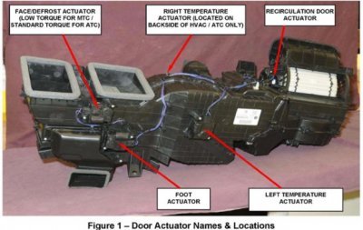

Check to make sure the blend door actuator is working for the temp blend door. A lot of times they go bad and get stuck either on cold or in the middle
Where is the blend door you are referring to and how can I watch it operate?

I believe it's behind the center stack, according to this diagram anyway. To hear if its moving, turn the key to on but don't start it. Turn the fan speed to it lowest setting and then change the temp from cold to hot to cold. You should hear a motor moving as well as the sound the air makes will change.
