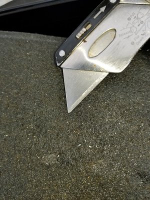

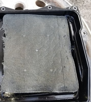

OE is a piece of media sealed in place.
How restricted is this? Don't know.
Top side:
Bottom side: Some small stuff and bronze sliver.

Look at Ed's post above (#45) that's what your filter in your lighter duty 8HP45 resembles,no canister filters in any of the 8 speeds.The only way to replace the transmission filter in all of the newer 8 speeds is to buy a new transmission pan,as the filter is part of the pan itself. That goes for the little 8HP45 you have right through the complete line of 8 speeds used by FCA whether it be the 8HP45 / 8HP70 / 8HP75 / 8HP90 / 8HP95

Looks like two layers like most I've seen.Open up the two layers and have a look.You'll probably be surprised at what's in there.That was the first thing I did when I started tearing into a trans.
