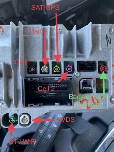

What are the plugin connections all for on the back side of the radio ( red one mainily) is it cell or backup camera or what .

I am interested in this thread! Just bought a 1500 20 Limited with the big screen, then a 19 camper fitted with a wireless backup camper on back. Would be slick if able to put that signal into the Uconnect. Can it be done?
