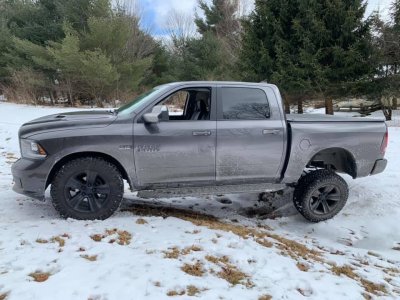

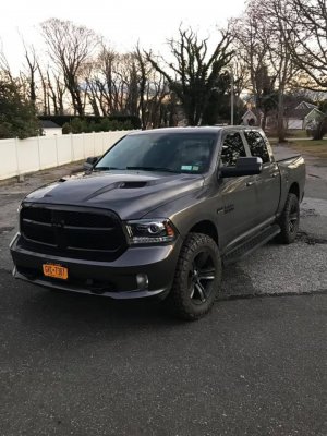

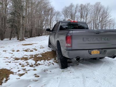

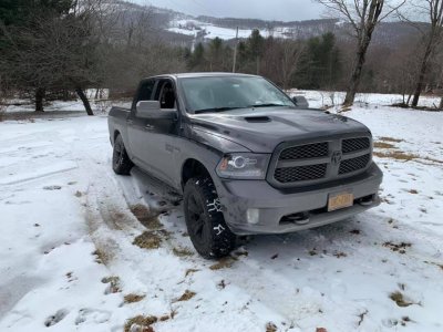

Ok thank you for the input. I will talk to nick and see what are my options but here’s my truck and some shots of me getting some flex in. I also have new Bilstein 6112’s that I recently bought but I will be installing this weekend.
That changes the plot a bit bud!, I'd definitely look at icon 2.0 shocks. I have the 6112s and you'll be happy with the upgrade over the 5100s. They are digressive valved as are the bilsteins which is why we mention them, they will balance well.
Truck looks good!!! How far upstate are ya? I'm in jerzzzz
