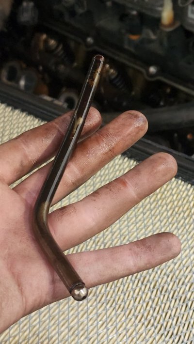

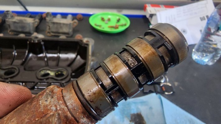

Hi, I have a 2012 Ram 2500 with 230k miles, that had a pretty bad ticking and some codes: P0306 P0456 P0300 P1524.
I decided to immediately pull the valve cover rather than swapping coils or anything, I knew the manifolds had been recently replaced, so I knew it wasn't that. Pulled the passenger valve cover and cylinder 6 intake pushrod was bent pretty bad(picture). The exhaust pushrod/rocker is also pretty loose.
I then pulled off the intake manifold and pulled the vvt solenoid to check if there was metal, and there was a small amount of metal(picture).
I'm looking for advice on whether I should just replace the lifters, cam, pushrod, etc. or replace the engine with a new/reman engine; and where a good place to get an engine would be? I see powertrain products has reman ones for $4k and lowest I could find from a Mopar site is $5,600 for a ram.
I've heard the way dodge/ram decides is if there is any metal in the vvt solenoid screen, but also seen people on forums say it's fine, just do a couple frequent oil changes.
Also, the one code P1524, says it has to do with low oil pressure, and the engine has 230k miles, so is it worth just replacing the cam and lifters if it possible oil pressure problems, and has high mileage.
Any input would be great, thanks!

Those are some pretty big chunks of metal on the VVT screen,i'd replace the engine,especially if it has 230K on it.
I agree with 04,the reman might be your cheaper option in the long run

Just curious, what do yall think the bent pushrod is from? A lifter siezing in a high position, or cam being ground down so the pushrod modeled to somewhere lower than where it sits in the rocker arm and hit that? How would it have hit the piston?

If the cams ground down enough or the lifter broke,the pushrod could of fell out of place,and then bent on the next lifter rotation

If there is significant metal in the VVT solenoid, a reman engine might be the best route to take.
Having said that, I tore down an engine that didn't have any metal in that solenoid despite the total absence of one cam lobe. So it is sort of a crap shoot.
IF you go with the cam, lifters and associated parts you need to make sure that all the oil galleries are clean ............. those metal particles went someplace. Take a close look at the oil gallery where the front main bolt goes through when you have the oil pump off.
