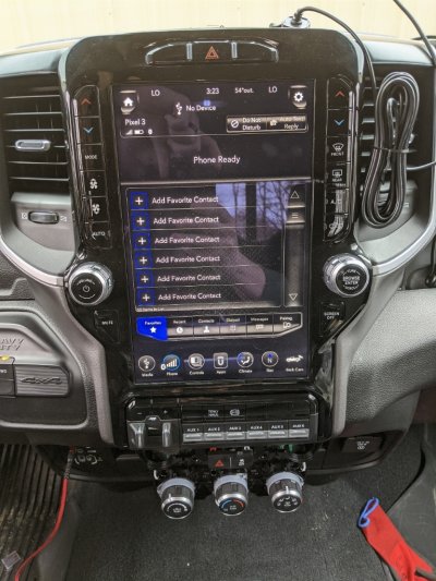

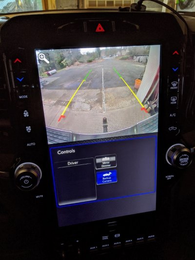

I managed to get the TSB #08-009-19 REV A performed locally after a whole lot of BS... Unfortunately they wouldn't give me a copy of the update to post on the forum here, but this update brought my truck from a very old July 2018 build, to a November 2018 build, and it fixed every single one of my problems. My reverse camera came to life, the sound quality is much improved and no longer way too bassy, the speed limit volume notifications actually stay where i set them instead of resetting to 15 every time i restart the truck, and I have a clock now. Thank god that's taken care of, here's some pics:

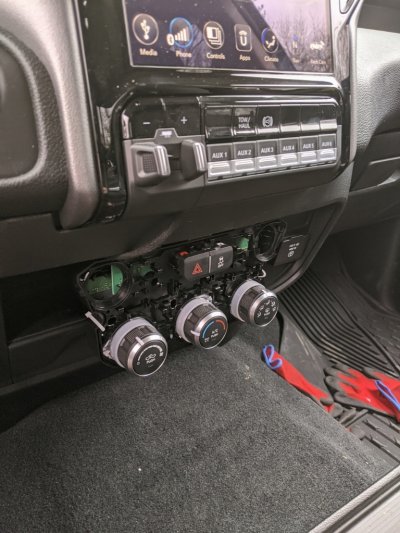

And i came up with a decent temporary mounting solution for the Manual climate controls until we can figure out how to convert the truck to ATC.
I was going to have a friend 3D print me a cover for the climate controls so they don't look all incomplete, but with this corona virus lock down i can't really get together with anyone so they can take the measurements they need... But I'll get something eventually, in the meantime they're no longer laying on the floor and they're easily accessible for continued use.

Good work! I like the way it turned out. For the climate knobs down low: the screen handles your fan speed and mode settings without a problem, right? Mine did. So you're down to just one knob you really need, for the temperature. Perhaps you could pull off the two knobs you don't need, remote the PCB nearby, and then use a short piece of rubber tube 9or emissions hose?) to go from a place on that dash (maybe use the simpler lower control unit without the 6 aux power buttons?) you mount the temp knob to the temp switch there on the PCB? Instead of a cover you'd need to mount the temp knob only, maybe easier?

It seems the Manual controls override anything taking place on the touch screen, i'll change the climate control over to dual zone automatic and see what happens.

right, but if you leave everything alone except the temp control, the screen still governs for fan speed and mode, yes? If you change the coding to dual-zone automatic you will kill the function until you set it back to MTC.

I think i tried setting it to Dual zone ATC, but the manual controller continues to override the touch screen. But i'll try it again later.

I switched the truck over to dual zone MTC, and now the touch screen seems to control everything except the temperature like you said.

So setting the climate control to dual zone manual seems to work pretty well, the only thing is using the red and blue buttons isn't reflected on the screen. Also I don't know if it was coincidence but while driving like this I thought I was getting an electrical smell from the vents... Don't know if I should be concerned about that. I'll see what happens tomorrow morning.

I decided to change the climate control to Dual Zone ATC, it seems to work alright in manual mode.

If that shows your temp slider move on the screen as you spin the knob down below then great!

I eliminated the manual control, I'm just running the UAX, and it seems to do OK in manual mode. I'll plug the manual controls back in and see if they do anything while in dual zone auto mode.
