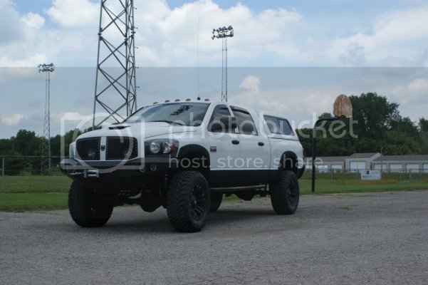

I used herculiner on my rocker panels and fender flares ... great ass stuff .
The key is PREP it VERY VERY well !!!
And get the bottle of UV sealer .... keeps it shiny like day one !

3 things you will need
I used a orbital sander to scuff the paint
Then you get this

I have always hated herculiner. Than I saw Dave's truck in person and it looked great. The prep is definitely the secret.

I've never seen Herculiner in person, but based off the pictures above I wouldn't be afraid of it.
