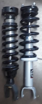

Its a new shop. Yup, I asked for side by side pics.
If it sits lower in front, I might pull rear spacer out.
You may need those spacers to keep those TT coils fully seated when offroading. I think your rear Fox shocks are 26.85" extended. Stockers are 25.5, and your TT coils are 1" shorter that stock.
Good catch! Thank you Sir. I dont offroad. None the less, good catch. We'll see in a few hours.

So, he sent pic and said he was wrong. Same size. :buttkick:
I'll update more when I get truck back.
ICON vs Rough Country
Yep that's pretty much same length and what i was expecting to see. Both should be extended travel. The stockers are shorter in length by about 1". 5100's are a tad shorter than stockers or same length. I can't remember from the pics side by side.

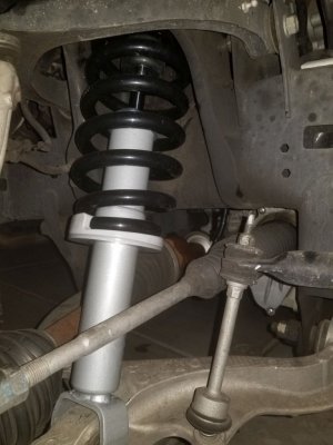

Rough Country N3 installed pic.
