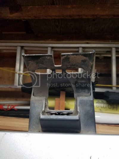

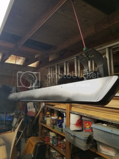

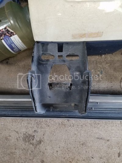

OK. They aren't pretty, I'm still painting them. I took over all pics, top and bottom, and a close up of the brackets

Rivinuts are preinstalled!!

The bigger holes match up to the captured spring nuts in the body.
The two smaller holes with the captured spring nuts in the step bars match up to the holes in the bottom body seam/pinch weld. Those spring nuts will sit flush up against the outside of the pinchweld.
Those should be 3/8" hex head bolt about 1/2" in length to bolt to holes in the lower pinch weld. I don't remember the pitch of the thread but you can slide out the spring nut and take it with you to the hardware store.
