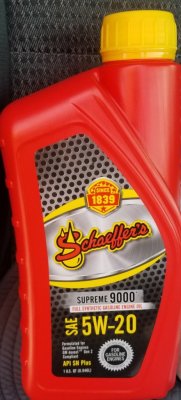

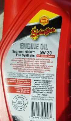

Has anyone used this oil in the past? I've read on other Hemi forums it reduces the notorious "tick"? Schaffer's 5W20.jpg Schaffer's 5w20.jpeg

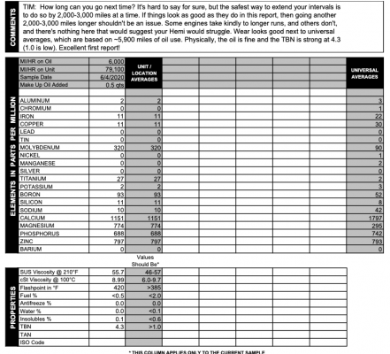

This uoa looks real good in a hemi, and the forum has done a lot of testing in ticks and moly, so zero doubt to why hemi's respond to this formula at 320ppm. The 7000 line up has real good moly as well.
Read the redline tick thread and the lubegard biotech tick thread, both have polls. Moly seams to be one of the keys to this deal.

Dang, wish I would’ve found this thread a long time ago. After reading some of the comments here and after seeing the Blackstone report that @Burla shared, this stuff has a lot more moly in it than even what Amzoil signature series 5W 20 had when I ran it and got a Blackstone report after. It’s moly content was only 175 ppm.
I guess I’ll find out within the week or next week how my Blackstone report comes back on the Schaeffers I ran. Hopefully this Mobil 1 extended performance won’t be a downgrade.

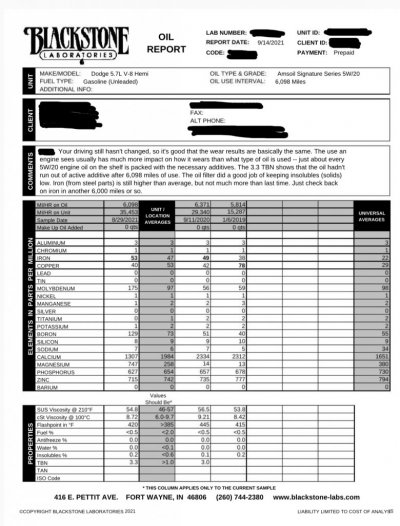

I’m not even sure where the closest Napa is to me so a year ago when I changed my oil and put in this Schaeffers 9000 supreme, I ended up ordering it online and I think I paid about $70 for 7 quarts. But yeah, like I said in my above post, I’m really anxious to see how the Blackstone report looks because I was surprised that the Amsoil‘s 5W20 signature I ran before the Schaeffers only had 175 ppm of moly and this stuff is over 300, even on a 6000 mile interval. Not only that, the TBN was like 4.3 whereas the TBN on the Amsoil was only 3.3 on a 6,098 mile interval.
