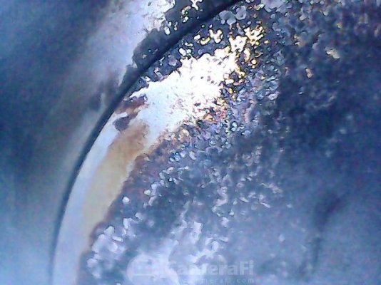

The cleaner developed by chevron, better known as techron. A detergent as opposed to a weak solvent, which sea foam is. PEA is in many fuel system cleaners, all high end, the cheapest with PEA is the gumouts likely. Where sea foam excels is the process, nothing better, but if it has to be run though a gas tank for injectors, it needs to be PEA. This is ram forum member hemi395 piston after running it for a couple weeks.. redline si-1 pic here, good cleaning seen, obviously more needed.
