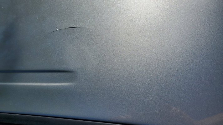

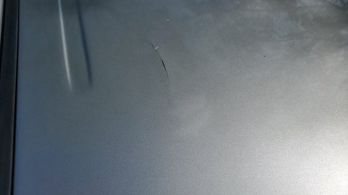

Fast forward to March 2022 and as I'm cleaning my windshield I jump up on my running boards and notice that the paint where the damage was has a big scratch, but upon closer look, its not a scratch, but a crack in the paint.
I call the dealer to get this fixed, "We'll get it in at the end of the month becomes, April, becomes May, after repeated calls I can get it finally the first week of June.
For my own curiosity, I run a simple fridge magnet over the room panel and it sticks everywhere, but the place where the damage was originally. Come to find out, the body shop never replaced the roof skin, they slapped down some Bondo and painted over it.
The dealer has agreed to repair the paint issue and they don't use this shop anymore.
Here's the deal, the dealer is claiming that they can't treat it as warranty because they can't go back to the same shop because they stopped using them as a vendor, fine, that's not my problem, they are going to fix it anyways, but I've asked for a loaner or a rental because I can't be without a vehicle for 7 days. Dealer claims that because they can't do it under warranty I need to find my own transportation. I reject that argument because the repair wasn't done right the first time, a lot of haggling and he asks me to meet him half way and cover half the cost of a rental. I again refuse, now it has to go to his manager. So here I am with a bad paint job on a 2 year old lease with 16k on the odometer which needs to get fixed and a dealer that is not giving me a loaner to fix their problem. Given the car market I don't know if I'll be leasing again in a year or buying this truck.
Am I in the wrong here for wanting a loaner/rental on the dealerships dime?
Should the body shop have replace the roof skin? I doubt that they even worked the metal to reshape it as much as was needed before skimming it too. In one of the attached pictures with the rib on the left you can see the raised oval under the split where the Bondo doesn't even appear to be flush with the panel.

Do you have the paperwork from the repair ? If so does it say they replaced the skin ,or repaired it.

The fix looks worse than the original damage. That sucks.

That's some novice work I must say. I'm lost for words.

Hindsight is a wonderful thing, but I would have either not taken the truck, or taken it as-is with a discount for the roof situation.
Replacing the roof skin is a big job and I wouldn't want that being done by an average shop.
Insurance body work or dealer repair bodywork is always done to a price point.

WOAH, THATS A LOT OF FILLER! You have every right to expect a loaner during this recall of a bad repair. That could have been massaged then repaired quite easily. I personally wouldn't have recommended a new skin for that. For that to lift within a year of repair??? That's nuts!
