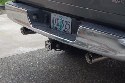

To install the dual factory tail pipe you will also need theses on the driver side
Isolator 52103718AB
Isolator 52103717AB
Hanger 52122572AA
Bolt 06104390AA

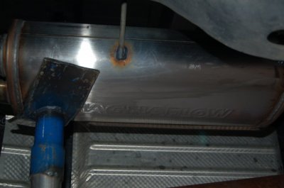

On my 3rd gen MegaCan Hemi I removed the stock system from the muffler back and installed a single in/dual out Magnaflow muffler. The exhaust shop bent up two new tail pipes for me.
The sound was great with a nice burble at idle, low rumble at highway speeds and when you got on it the truck got loud and nasty.

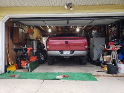

I run a si/so carven AR1 - y pipe - no res - 4x16" black tips at 45°
If you're gonna spend the money, why do it to look like 90% of the other rams on the road?
Excuse the messy garage, it was the change of the season.20190418_175100.jpg
