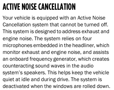

See if it occurs with the windows rolled down. It could possibly be the ANC system. If it occurs with the windows down, then you can eliminate this theory ;)
