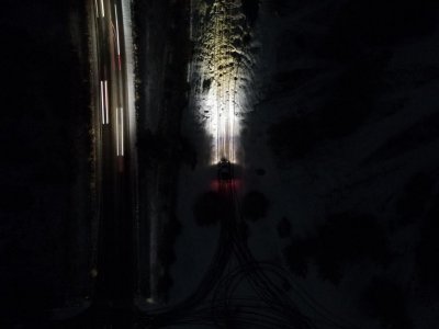

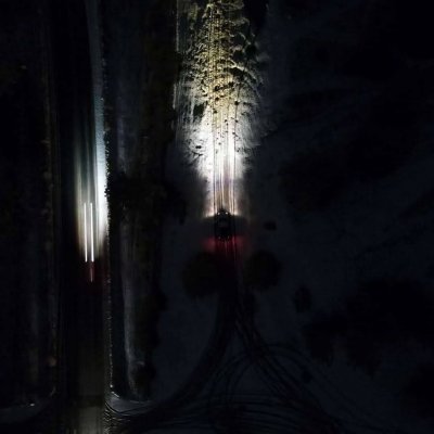

I don't think "we all know the headlights suck"... my truck's got the quad beam (Tradesman trim) lamps and they're very good. That tells us one of three things;
1. I have a magical truck built by Santa Claus himself to be better than everyone else's
2. The headlights are actually fine and people just like playing dress-up with their trucks.
3. The headlights are crap and Ram bribed the department of transportation and me personally to let it slide
If it's the 1st one, sorry man maybe get on the good list and next year Santa will build your truck super nice. If it's one of the other two then yes higher-output bulbs will be an actual upgrade.
Keep in mind that the point of headlights is that you sit inside your vehicle, look forward through the windshield and meanwhile light comes out of the headlamps and travels forward through the air where it eventually intersects with objects or the ground, then light reflects from those solid surfaces and returns to your eyes which provides you with information you need to drive safely.
I spelled that out pedantically for a reason: headlight effectiveness is not determined by how "bright" it looks when you're standing outside of your truck and looking back at it. You don't drive from 20 feet in front of your truck looking at the headlights and from standing height they should appear dim anyway since you're above their focal cutoff.
Here are a couple photos of my regular Tradesman with $23 Wagner ND bulbs in the low beams, taken with a drone while random cars drove by on a nearby road:
I'm not seeing a suck..

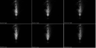

I tried to get to the bottom of the LED thing too, on my Jeep (it's much easier to swap headlight bulbs in 60 seconds with that vehicle than the Ram & I wanted to get this done without moving the drone, or landing/relaunching it)
So in this series of photos (2015 Jeep Patriot, stock headlight assemblies) I started with the 5 year old OEM (Sylvania basic bulbs), then Wagner ND (incandescent) bulbs then with the very best LED headlights I could find based on forum opinion, online reviews and manufacturer marketing - Hikari 2020 (the most expensive series, eye of megatron I think.. ) to help ensure the best possible result. Drone camera was set to manual mode, fixed exposure so the brightness comparison is apples>apples.
The good news is it turns out if you actually spend the money on high end LEDs they can have pretty good pattern. I can tell from everyday sharing the road with other people that a lot of a-holes are NOT buying high quality because their glare cannons look like trash but from this experience with the Hikari lamps, at least it is possible to spend the money and get a good clean pattern.
The even better news is that $23 halogens are still superior once you eliminate the bias people naturally have toward "clean" bluish light. The 6000k LEDs just disappear into wet pavement, wet dark colored vehicles and wet tree bark. I think if somebody made 4000k or 4400k LEDs that problem might be averted but so far nothing anywhere near that color exists for some reason.
End result was I re-sold the LEDs and kept the Wagners. I can actually see in wet conditions with them and even in the best conditions they're just not inferior to the LEDs. Maybe they don't have that "clean white linens" color to them but I'm pretty sure the number of times I get laid isn't going to be affected by headlamp color so I'll be all right.
