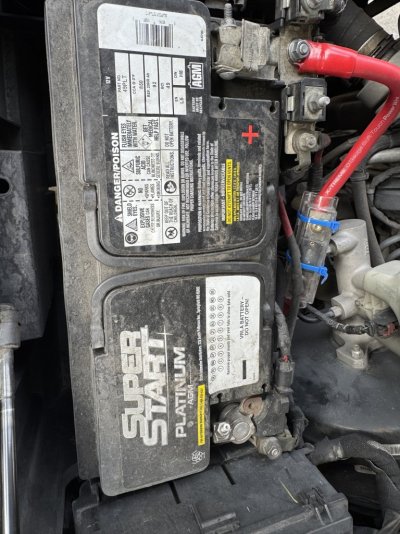

This is my current battery but if i upgrade to the odyssey 49-950 would i need to change my alternator as well?
I've had the Odyssey 49-950 in my truck('15 EcoD) for a few years already, these trucks already have a higher current alternator(240a vs 180a) than the Hemi trucks.
New battery, do the big 3 wiring upgrade, use properly sized wire to the amps and consider a good 1F cap attached to the amps wiring, see where things work from there. As for second battery vs larger alternator that is more along how you going to use the system. An alternator can only put out so many amp if your just idling.

While running new wires consider using pure copper wire. From the pic you posted of your battery/amp wire connection I’m assuming it’s CCA wire unless you spent a lot of $$$ on OFC wire. CCA is cheap and has current loss at higher power levels.
