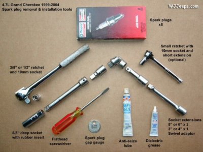

Good job man! I need to so this badly to my truck! I need to go out and buy everything needed though since I never done spark plug change and plus apparently my sockets went missing. So if anyone has any great pointers on what all to get that be great!

This picture shows pretty much everything I used....would add a 2" extension bar too though.
Next time going to try something like Redtruck suggested above though.
