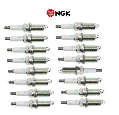

I ended up with iridium NGK plugs. That’s all I could get in 16. What new spec says. Dodge did it last time. So spec. No luck with Delphi boots. They sold the last set. Looks like I’ll leave them alone or have to settle for car quest premium. My main goal is 2 of my 5 boys. They were in a moderate car wreck with their grandpa today coming home and they are not doing real well. They are home, but I bet we end up in the ER. I didn’t even think about Taylor or a race wire. Well looks like I’m going back there. I honestly wish I had just went to summit on Thursday. I would have been closer for my boys. I couldn’t get through the traffic fast enough.
