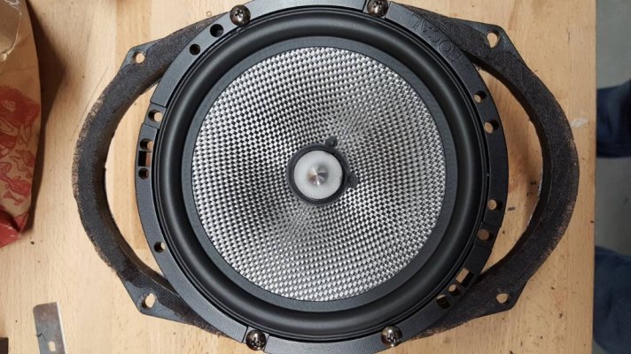

Here is the plastic spacer I took off the rim of the factory speakers. It gives about a quarter inch of room for the speaker magnet98893a73c8626dff5e8b68540132db1d.jpg
You should take that spacer and use it as a template to make your own adapter. The front of the speaker should be isolated from the rear of the speaker
b5rider
May 21, 2016
118
17
Oh yeah, don't use this for a 6.5" speaker. It should work for the 6x9

Not sure about the spacers from the OE speakers you had but the ones out of mine are just a bit short of a half inch thick? Also, they wouldn't seat flush on the Kicker 6x9's. Simpler to just get them from Amazon or EBay. I found half inch ones for $12 a pair w/free shipping.
