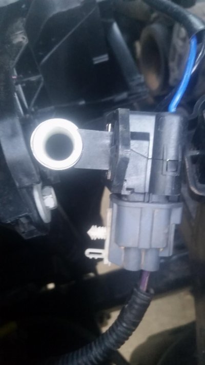

Did you try the tyco fan? It plugged right in where the AC fan did. I installed it last week
https://www.amazon.com/gp/product/B0054RMKZC/ref=oh_aui_detailpage_o00_s00?ie=UTF8&psc=1
I'd like to see some photo's if possible. Did your 2014 have just a 2wire harness running the E-Fan and is that fan a 2wire plug?
If possible please show the fan installed and the plug installed.
On a side note have you noticed any vibration, some people have complained about vibration when that fan is running?
I'd still like to replace everything with an electric fan, I hate the look of a half taken apart truck, (remove the stock crank driven fan and using only the factory E-Fan in the stock shroud}.
WadXpress
Nov 29, 2014
1,162
399
HEMI
yes both 2 wire. no vibration yet. the stock shroud wont fit over the efan i tried
