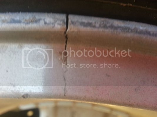

Inside of the rim perpendicular to the bead a small crack formed. Dealership says not likely to be covered by Chrysler. Tires fine and wheel is still round. Definitely was not impact or negligence on my part or I would just take my lumps.
Happen to anyone else?

Had a slow leak, so put on spare, and ran it in to the tire shop, and they found the crack before they took tire off. Sent the pictures to the service manager, he is going to send them to the district manager. He wanted me to bring the truck in, but 100km away, and the wife needs it for her work(delivers mail) right now.

Damn, that sucks... Gonna be hard pressed to prove that's not caused by impact though...

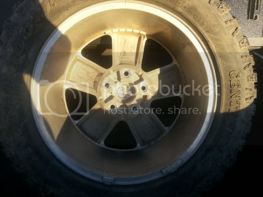

Is it just dirty, or has the rim been scraped against something? It likes like curb rash when rim is rubbed against a curb except it is on the inside surface. If something was straddled that was high enough to hit the rim I imagine it could cause a crack like that.

Ya I hear ya, but not much to impact on the wife's mail run and the tires are fine. Even if she hit a curb or something, you would think a rim on a 4x4 could handle that. I work in the towing and recovery business, I have had new sports hit big rocks that slid off the mountain have their lower control arm etc ripped off from the force and still hold air lol.
Back in 2010 I had a Dodge Caliber and we hit a gouge in the road, destroyed the tire and bent the aluminum wheel. It didn't crack, and we sent it off to be repaired and was fine. Still see that car around town and Rim is still holding up.
Definitely not rash, just dirty I imagine, the only other damage I found were the odd rock chip.

That looks more like a repeated load cycle crack to me. Which shouldn't happen, unless there was a casting void or something.

A good wheel repair shop can weld that up and balance it you wont even know it was repaired. I dont think it would be guaranteed but you can try!

I don't see any bends, dents or obvious impact points. I would demand a new rim under warranty as its a safety issue and they can't prove it was caused by an impact. Could be a flaw in the aluminum or manufacturing process.

Aluminum wheels crack all the time. You are not the only one. Ive personally seen it on stock f150 wheels (~2011) and a f350 (~2007) and numerous small imports, usually with aftermarket wheels. Stock wheels are almost always repairable where aftermarket one go in the scrap bin.

I don't know for sure, but it kinda looks to me like there is bit of a flatish spot to the right of the crack. You probably couldn't know for sure unless you spun it on a lathe or a wheel balancer and dial indicated it for runout, but it looks "less round" to me.
