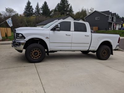

18" wheels and Tires will give you a softer ride with more sidewall. Nitto, Cooper, Toyo all offer good tires in what your looking for. Check out Tire size .com. If you want to fill out your wheel wells 34 or 35" is a good choice. I have the 2" ThuPXL_20201008_183031357.jpg ren front coils and you would still have some rake if you keep the Rear stock coils.
