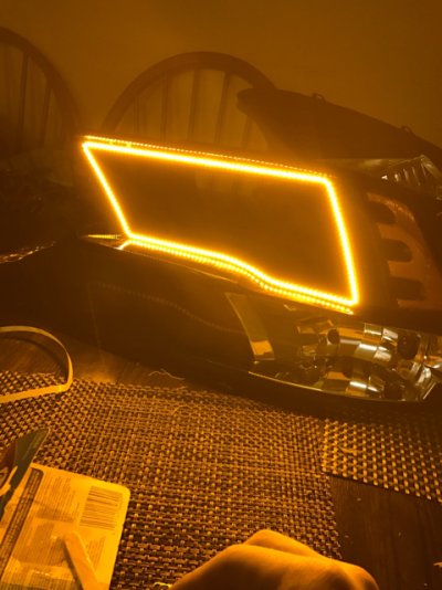

Finally after a lot of stress and some you tube help I got them installed!! Here's some pics! Learned a lot! e33fddf2d573043f67f7c0064486d925.jpgb19f8e3ddaffb029d651936d5408704b.jpg

Led concepts . Wasn't happy with how they sent zero instructions.... could only troubleshoot with them via email. No telephone troubleshooting though them . And on a ram you need to wire in resistors (which they had no knowledge about ) I learned on my own how to make them work. So if you have any questions feel free to hit me up if you go that route ! They are sick tho! No one else has em that I've seen.

Yes I probably did call you! I called many people! I kept original 3157 bulb...
The issue wasn't the bulb tho. I was getting a hyper flashing without having a resistor installed . I had to install a resistor on the ground wire of the parking lamp/turnsignal harness . The resister had to be wired with both ends wired into the ground wire . Very simple fix that no one could tell me to do, not even led concepts. Just trial and error on my part.

Only issue now is I must not have sealed them the best . Driving in nasty white out snow/slush storm for 200 miles the other day and got some fogging inside the lense. It's gone now but def gonna have to bake , clean out the butyl, and reseal sometime. Any recommendations on any anti fog stuff to put inside lense when I have them apart?

It was pretty bad . No pics because since I ran the headlights and the weather cleared they are good .
As for the resistor I felt the same way. I originally had one end of resistor on the ground and the other on the parking light power. Then switched to turn signal wire . All the same result ... hyperflash then out . With it wire to ground only on both ends .... flawless .

The wires come out the same grommet the harness goes into . I may spray the back of the harness with some flex seal and possibly around the seam where the lense and housing meet too. But just checked them this am , not a sign of fogging so next test is the car wash!
