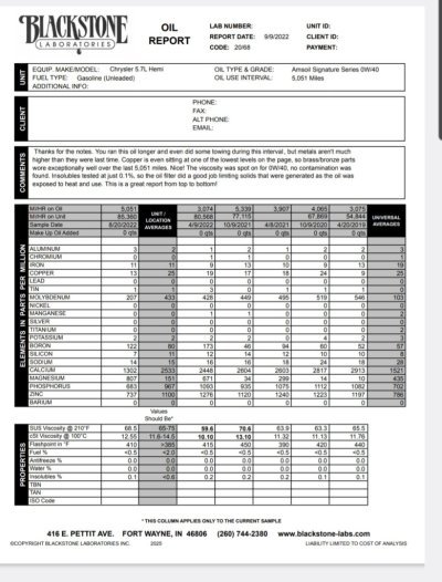

Regarding the shearing of Amsoil SS 0W-40, I posted this UOA several months ago in the Blackstone thread. But here it is again:
I did not do a VOA on this oil but according to Amsoil's specs, the cSt Vis at 100*C is 14.8. As shown in my UOA, this dropped to 11.76 in just over 3,500 miles. While the engine in my truck does work hard, I expected better results from this oil. I also had a lifter tick on startup if the engine wasn't started for more than a couple of days. I used this oil for many thousands of miles but after seeing this report I have changed to HPL P+ 5W-40 and don't plan on going back to the SS 0W-40. I am not bashing Amsoil; I have used their products for literally decades and still do. Just not this oil.
But as we have seen with these engines, if your oil strategy works for you, go with it!

All I can say is most 0w40's even redline you can expect the same. The only way to avoid it is to use super class 0w40's which are on the line 12.5 starting visc. Those tend to lose less % then the heavy ones. Especially when in a hemi, these machines simply shred visc. I might consider a 15w40 which will shear much less. You see that wear despite low miles, just mean your hard on the oil. Other applications will lose less visc, but generally speaking not any hemi.

Totally forgot I have a SS 0w40 UOA with the SP formula. It did sheer down a bit, but it could also be some residual RL 5w30 mixing in there as well.
It definitely doesn't sheer down as much as PUP has on most UOAs I've seen...
The sample shown above showed sheardown in 3,000 miles. Down to 11.79 cST.
