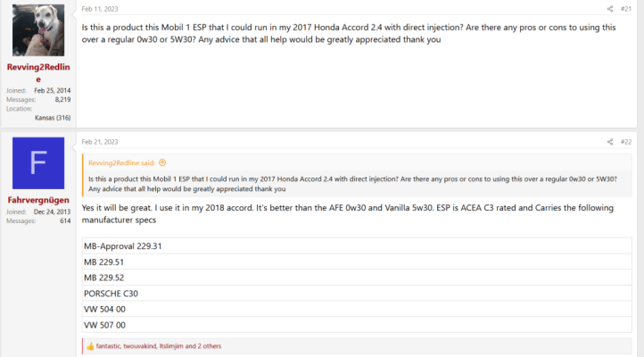

Travis likes this for di or hemi? Looks as good as anything for the hemi.
DI. I think we agreed M1 ESP 0W-30 doesn't have sufficient Mo added for hemi.
Hence, HPL SC 0W-30 for Hemi (lots of Mo).

It has esters/pao with visc 12, yeah ok not 200ppm moly but literally everything else was a win. If another voa verifies that ester count, like newsflash we have an OTC redline clone better in many ways maybe not moly. Not sure I'd run a 1700pp, CA with no mag in a di, but different strokes for different folks.

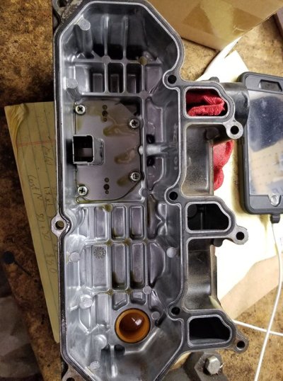

Well, I went out to the barn and discovered I'm out of diesel motor oil for the tractor, so I stocked up with two years of my usual oil. I know it's changed over the years with API ratings changes and who knows what else, but I will say the motor runs great with 2,168 hours run time in HARD use (near full power mulching 3 seasons, and snow in winter), and the valvetrain looked like new when we opened it up to adjust valve lash @ 1,200 and 2,000 hours). Clean, no deposits, no wear marks. Awesome oil...

Looks new.

I like ESP 0w-30 in both DI and hemis. Mobil states on the website and bottles it meets API SQ engine test requirements which covers LSPI but it has to much phosphorus to be an API oil. Also MB229.52 has an LSPI test. Similar to the dexos spec but the LSPI test is less strict or atleast thats what i read

It's the additive content that's bugging us, Trav.
How could only Mobil get away with old-timey beaucoup Calcium and no Magnesium yet not cause LSPI?
