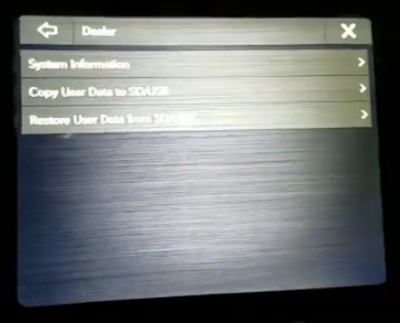

Kinda good news, I was playing with the buttons and got into Dealer Mode by pushing the far left and far right icons at the bottom of the touch screen for 5 seconds. There I found my software version listed as 18.20.37. How do I get to 18.45.01 from here, is it possible? While I was in there i backed up my user data to a USB stick just in case I lose anything. Weird thing is I cannot find any information anywhere about 18.20.37....ugh.

Here is the video for anyone that wants to help me upgrade, I want to be up to 18.45.01 if it's possible. I see no mention of this version anywhere on the web.....

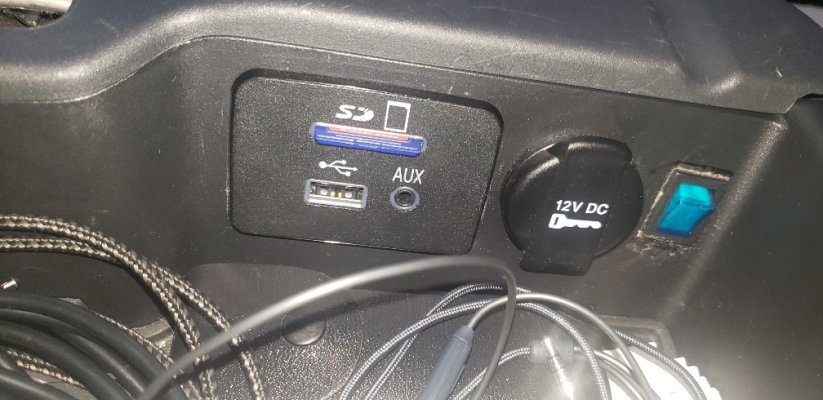

Yep, mine has been changed, I have USB on top and Aux under it. No SD reader but that doesn't concern me so much as long as my Bluetooth works.
