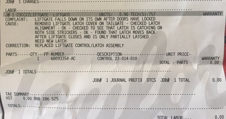

There is a TSB out for this problem. I was having the same issue on my '16 Big Horn. The dealer found the TSB, I don't have the #, and replaced a part in the tailgate. This was a few months ago, and it has been fine since.
I don't have my work receipt nearby for the info on what was replaced.
