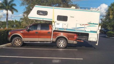

a slide in is likely way over payload.
Slide-in over payload...not for this guy:
When using ramps to put a load in the bed, only about half the weight of the load is applied to the tailgate. Unless the ramps hang entirely off of the tailgate.
Some obvious issues with this load, but I noticed the tailgate looks fine.
