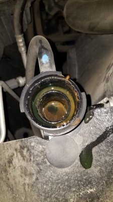

I took a look at my oil, mostly black with a little brown. I didnt snap a picture but I'll do that in the morning. Neighbors are getting cranky. Here's the gunk I spoke of.

Might be a good idea to drain off some using the radiator peacock, you can use that to drain some off and inspect, and put back that amount, without having to burp system.

Id be concerned about what looks like green coolant in your system, which does not mix with the HOAT coolant that your supposed to have in there. That could be what is making that slime in your radiator
Great point, take more pics and drain off some and take pics, clearly that isn't just orange hoat, and if you didnt touch it, the dealer cross mixed coolants.

Since I didnt know what HOAT was, I looked it up and looked for the bottles I bought.
My overflow tank had fluids in it 2 days ago, now its bone dry. I'll look up where the plug is and pull some fluids. I'll schedule an appointment for an oil change, and a radiator flush. I'll ask them if they see any issues. Probably be a week or two, with holidays coming up and snow heading our way. Would buying some sealant fluid help in anyway?

That's probably not the worst thing to put in there, but I don't like the "one for all" coolants, I would go ahead with the flush, and see what happens from there. I would advise against any stop leak

I'd completely flush your coolant and replace it with Zerex G05, you can buy it at any auto parts store. Prestone makes a good radiator flush, you can buy it along with the coolant. My recommendation is not to put just any coolant in your tank because you need the additives that are in the G05. Best of luck
