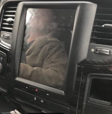

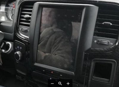

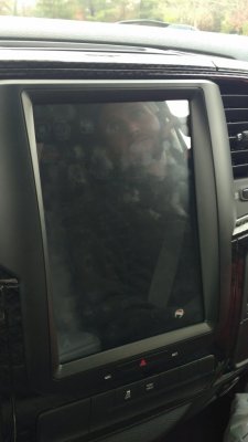

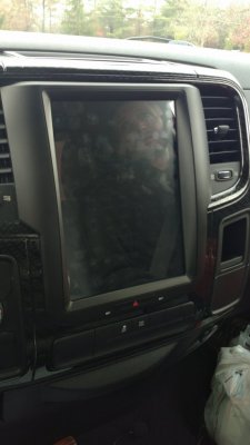

Looks like my Linkswell unit is going back too. I rec'd some new parts and it shuts down correctly now. But, this weekend was the first time I've used the truck during the day. This thing is so dim, there's time you cannot even tell if it's powered on. I have the setting in the upper left of the screen pressed 3 times to the highest setting and I have the two scroll bars for daytime/nighttime all the way to the right on the highest setting. Yesterday, I did some research on KitKat 4.4.4 dim screens. I then downloaded an app called night mode to try toggling that on/off as on some tablets it brings back the factory brightness slide bar. I also downloaded Agami car launcher to see if a different set up would be easier to see. No luck with either one. I emailed Linkswell last night with my concerns. Waiting for a response.
Here's some pics from both the drivers and passenger seats showing what the radio looks like on a cloudy, rainy day. This thing is totally useless.
Your faces in the photos say it all.
That's kinda bulls**t, man. Sorry about that.
