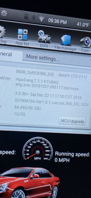

Hi, newb here. I have a 2011 Cadillac CTS with a Tesla-style HU. I know this is a Ram forum, but most things I’ve seen here apply to my application too. I’ve read every page looking for a solution to my problem. Holy crap I have learned a lot along the way! My UI is looking pretty sick now lol!! Thank you! My problem is the climate control readout in my console is stuck in Celsius and I don’t have the “unit” option in the console settings to change to metric (which has worked for others). I have Android 4.4.4 spoofed to 7.1.1 (another thing I’ve learned Here). Anyone know where else that console setting might be hiding? Also, I was wondering if anyone has the passcode for the Developer Settings area? I want to get in there and see if I can enable resizing so I can split screen two apps (Waze and Pandora ). One last thing, I’ve lost all sound effects to my car. No blinker noises, no dings, beeps, or chimes. Is this normal?

Check Advanced Settings, and on that firmware menu you sent the picture of, tap and hold on "20161207" in the middle of the text and another keypad should pop up. Those are also developer settings.
A Couple codes that may work:
8861
666888
1680
1688
7890
