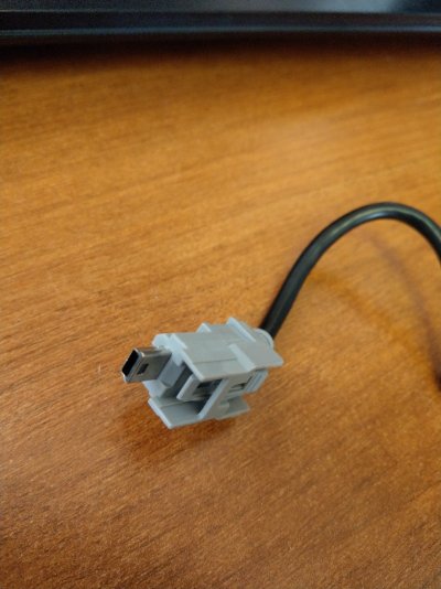

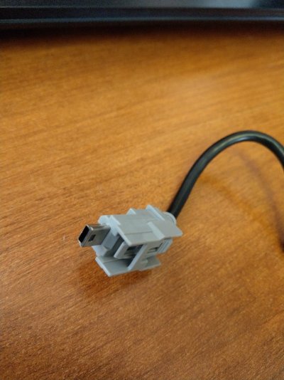

That's good, have you recently unplugged the radio and plugged it back in? Did you check the gray USB plug adapter on the back of the harness?
I did check with Linkswell... They told me it seemed like it "died"... When I asked if it was covered under warranty... They stopped answering.
If they sell it I would think they would warranty it...
I was able to upgrade the "box" (dongle) with it connected to the USB I have routed to the upper glove box. Seems to work perfect connected there. But, still nothing when I plug it into the factory USB in the console....even though it used to work there.
This is the factory plug that feeds it.
It also routes through plugs under your driver's seat. Ensure all of those are plugged in/undamaged.
You can eliminate the radio harness as the culprit if you have an adapter like this to plug directly into the radio's USB adapter in place of the gray plug above...
USB Host Cable mini B male to USB... https://www.amazon.com/dp/B00JK1OFOM?ref=ppx_pop_mob_ap_share
I haven't unplugged the radio recently... I did check under the seat and found the wiring to the USB. Unplugged and re-connected it there. No change to the USB connection in the console.

I guess the next step is to pull the radio out and check the connection on the back. Thanks for the info and pics!!
