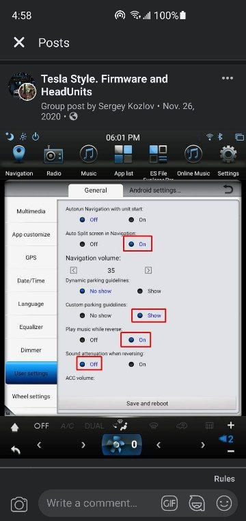

It's the stock radio player that came with the unit. I did download carwebguru and haven't had a chance to really go through it. I'm hoping see if I can get the cameras up and running tomorrow. I did see this post (in the pic) and was wondering if this may change it. a8b396740584ee9ad165f1c7cc7aa5d0.jpg

Oh, I misunderstood. Yes those settings are what you are looking for if the music turns off in reverse.
Edit: I believe the attenuation option halfs the volume in reverse or there is another setting somewhere called something like "reversing volume"

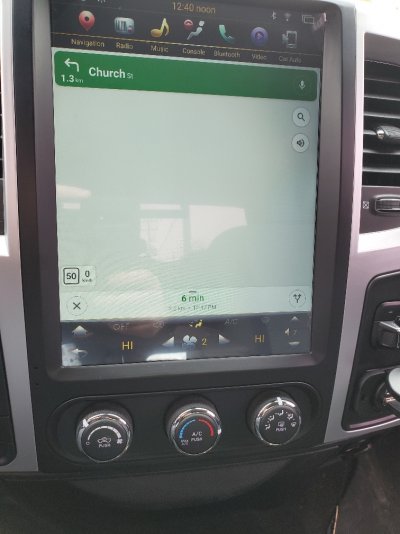

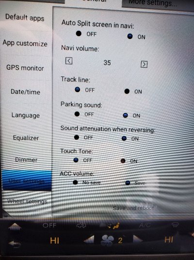

Ok so new issue lol I fixed the music stopping while in reverse. I tried to use Google maps and get a blank screen. I m not sure why it's like this. If I'm not using the actual directions it shows the map. Also I don't have the same settings for the music in reverse. The pic without the red squares is the way mine is set up. The attenuation setting worked for me though.

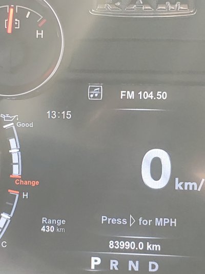

So I'm not sure how or what I did the time here. It wasn't 24 hour before. I looked under the console settings and it's set correctly as far as I can tell. Anyone else have this issue?c7253fd8a49965b6d83a406ed6060941.jpg

There are multiple places to change it in older firmwares. Try looking in another settings menu.

No luck. I found three different settings and no dice. All of them say 12h. Not a huge deal. Just thought if I could change it I would. I spent about two hours today playing around with settings and installing Nova launcher and a whole bunch of apps like Spotify and other apps like Alfaobd and obdlink. Love that I can do pretty much everything I can do on my phone on this thing!

You may be able to set it with AlfaOBD to correct the mismatch.
