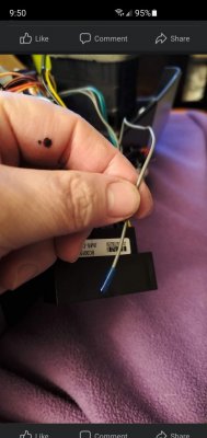

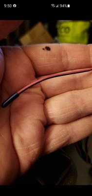

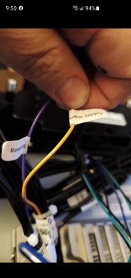

Hey guys, my px6 finally came in Yay! Question for you gurus. Pink with black wire, comes from the radio side of the main harness. Grey wire coming from the truck side main harness. Both these wires are not labeled and I'm not sure what they are for. Also I have two reverse power supply wires, one from each of the other RCA's harnesses. I assume that one or both can be used for the aftermarket reverse camera? I also have a front camera I'd like to hook up, can I use one for that? Thanks again guys, the unit goes in tomorrow!
Do you have a factory reverse camera?

No sir I do have an aftermarket tailgate handle camera. Looks factory though.
Is the aftermarket camera currently working on tour OEM radio? If so, don't worry about the extra wires and just try the plug and play route first.

I'd have to see a picture of what you are referring too. As far as I know the trailer brake should not get unplugged on the 10.4.
The two backup camera plugs are for when you have a factory backup camera. In your case you will plug the aftermarket camera directly into the radio side RCA of the harness.
