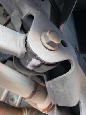

Need input on good upper rear control arm replacements.
Found moogs for 36/ea

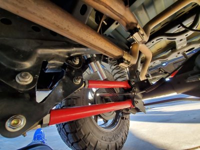

yes sir, I want a set as well.
@CAG CheechDogg installed a set on his lifted 2WD, they look great

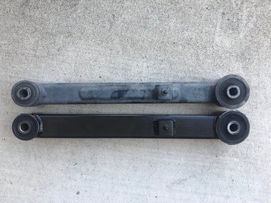

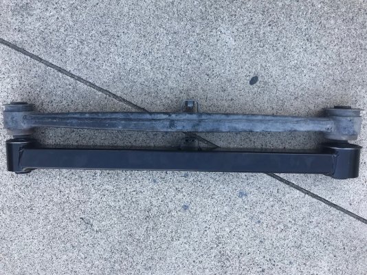

You can get the Mevotec Supreme arms,stock length, better bushing, better built arms. Replace both upper to match, Mevotech CMS251146 ($60 something each) or you can get the Moog stock replacements for $32 each, MOOG RK642932
Mevotec Supreme vs stocker uppers, they're not core4x4 but if you don't need adjustable arms with cool flavour colors, this can do the job. I may replace my lower rears with Core, just because i want to show them :) nobody looks at the rear uppers so who cares hahahaha.

If you have the money Core is the way to go. I’ve got Mevotech front upper control arms and ball joints and they’ve been working great on my 4” lifted 1500.

those are better looking, have lower part # by chance?

I agree that they’re better looking, stouter, but are they hollow or solid? That would be my main concern.
Im sure those are hollow, but tubing is stronger than solid bar, not sure if you were implying that solid was stronger or not.
