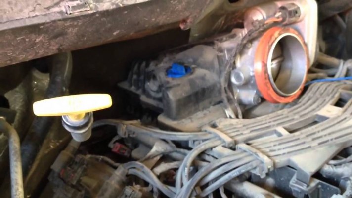

If you are talking about the line that goes from the oil fill to the airbox, thats actually the fresh air make up line. The pcv on gen 3 hemis is integral to the intake manifold. Here it is on a 03
The bright blue object. Thats the lil guy that ***** up the inside of the intake manifold. Along with egr, but not in 03.
Charonblk has a good write up on bypassing the pcv. Maybe he will happen across this thread.

Yeah, that's the line I'm talking about. When I looked at the exploded parts view of my generation 5.7 that was labeled as the crankcase vent line. Regardless, it was sending oil strait to the TB, I had cleaned the oil of ATS and put the small filter on the hose at the same time, haven't an issue since. I've been thinking of doing an EGR delete since it's starting to give me grief again, doubt I'll get any performance gains out of it, but it'll clear out some space.
Edit: The HEMI pictured is an older version as mine no longer uses plug wires. I did replace the PCV a good while back, didn't really sho wany improvement that I could notice.
