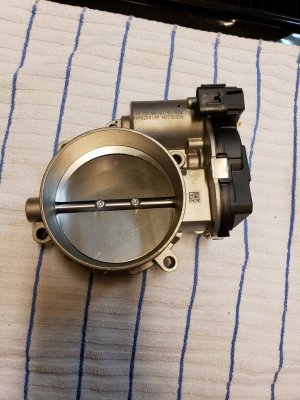

Hellcat TB. Why?? Because I could :)
I know it's not the end all be all in most HP for the dollar but being one of the first to successfully complete this mod is enough in my book

It's the 92mm oem Hellcat TB
cool I will have to google that one. Although I believe a 92mm is much to big for my current setup of mods. I think I need to stay around 84mm with just bolt ons and tune.

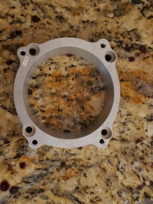

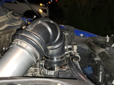

How about the hell cat one? Curious how the mmx adapter is working out
MMX adapter is solid. My only gripe is they don't drill for the locating tabs on the stock intake manifold. Nothing a utility tool can fix but for $190 bucks it would have been nice. Hopefully they'll get this feed back and make it better for future customers. I opted for the 90mm opening tapered to 85mm which matches the stock intake manifold opening nicely! :D
If Jay has dialed in this TB to be good daily-driver mannered I may go this route for future boost. Usually the problem with significantly oversized throttle bodies is tuning during idle/partial throttle.
