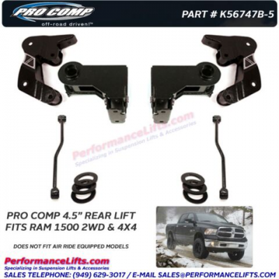

@crazykid1994 was this the Pro Comp rear box kit you were talking about ?

Yes it is.
