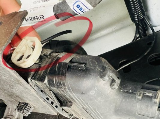

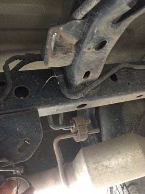

I have a 2024 Ram 1500 Crew Cab Laramie 4x4 and found the third brake light connection wire on the rear drivers side above the wire harness connector that is above the driver side tailpipe. Works perfect with my topper and a brake light isolator module was not needed.IMG_9483.jpeg

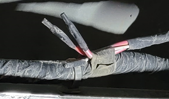

I've been looking all over the place on the driver's side for the purple/white wire. After reading this thread, I lower the spare tire and found the third brake light wire. Thanks!
