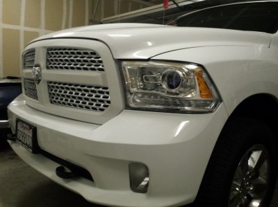

The Ram sport doesn't have an option for factory tow hooks on the 13 and up trucks because they changed the front bumper but you can install them and bolt them to the factory mounts on the frame. They will come extremely close to the bumper unless you put them right side on the left and left on the right. You will have to trim your bezel yourself because they don't make a tow hook bezel for the sport. I have done this as well as alot of other people and it's not that hard to do if you take your time. Sorry this isn't a very good picture but this is what they look like.
That's exactly what I want to do with mine.
Thank you!
