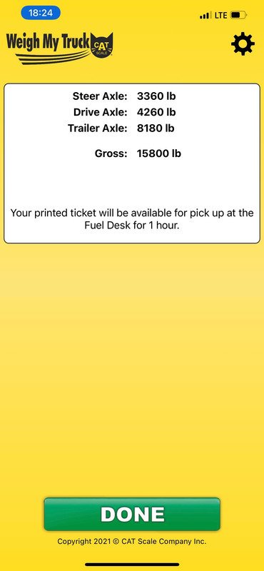

Make sure you go to closest cat scale and get your trucks true weight. Anything posted online is worthless. Subtract that number from the gvwr on sticker to get payload which as mentioned will be your limiting factor for your tow capacity once tongue weight is figured in. Good luck.

Depends on the type of trailer too. With a 1500 and a bumper pull travel trailer you will likely be reaching GRAWR limits at about 9000-9500lbs. Best way to know would be taking it to a CAT scale loaded as you would normally be towing it. Step-son has a 2020 Tundra (yeah I know not a RAM) but with his 2021 Grand Design Imagine 3250BH it weighed 9300lbs empty off the dealer lot and he was 160lbs over GRAWR with 12% tongue weight. His max GRAWR was 4100 and he was at 4260 and that was with the camper empty. I think the 1500 Ram has a 3900lb GRAWR.
This was the 3250 with the Tundra. Oh...and when he was trying to ack it up a small grade into his spot his trans overheated and the light came on. And his max tow was 9800lbs
