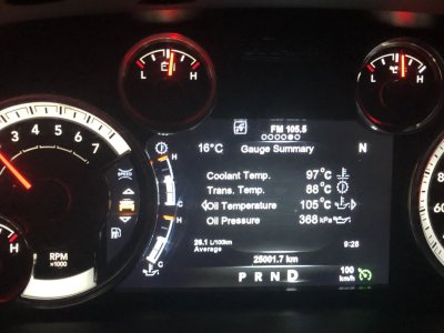

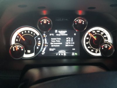

I have a 18. 5.7 321 And well we bought the truck and with in one month we towed our 21 ft hybrid max out at 5500 lbs for Canada to Disney Florida. I did pay attention to the temp that muck the we’re well in the green. Tomorrow I am heading to northern Ontario with the trailer will be keeping a eye on the real temps. Today hiway driving al the temp
Were below 100deg

Towing 101 km/hr Towing a 5000 lbs trailer northern Ontario and in traffic of Toronto.
