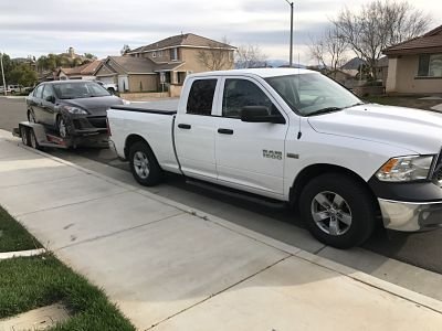

This was a older post of mine, hopefully it helps you out. Went from CA to FL.
Made it to Florida. Truck did well towing. I have not sat down yet and worked out my MPG and everything yet but I'll be sure to get that done soon. I can say that one tank I got over 14 MPG and on another tank I got about 11 MPG.
As far as temperatures goes the average for everything was about:
Coolant around 200 to 205.
Trans around 125 to 135, seen it as high at 150 but that was going up a steep grade trying to maintain 60 MPH
Oil temp around 220's
Oil pressure was always around 53-55 seen it go as high as 60 psi.

I don’t have a Power Wagon, I wish I did! I have a 1500 Trandsman 5.7 4x4 3.55 gears and 6 speed.
Trailer with car loaded with house gold goods came in at a little over 6,000 lbs
