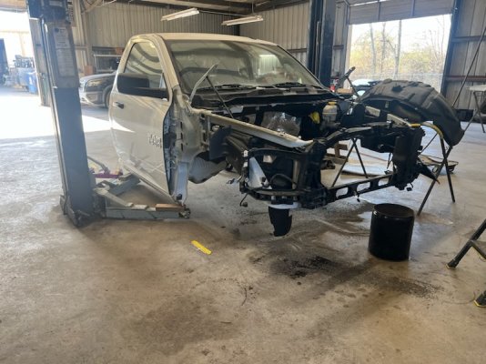

Lol, this is why I'm concerned about my RAM trucks transmission fluid/rad fluids, etc ... my truck was disassembled/re-built/repaired and put on to a new frame.
The collision repair center has an 5 Star rating, but seemed intrigued about my concerns about engine coolant fluids/transmission fill procedure.
<edit> This pic is of after all the frontal rad/fender supports has been replaced.

JHoward
Jul 26, 2021
1,486
4,278
NW Louisiana
... after repairs. Exactly six months(Nov. 2 last year to May 2, this year).
I'll post a better pic later.

I'm still amazed they didn't write it off. Does it still steer good?
