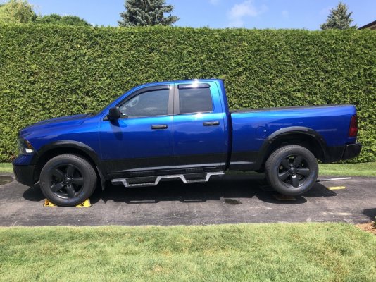

Ok, I know you used a incline for your truck right? But how did you get the wheels off the ground to go into 2nd gear?
Car ramps to get it up initially and then jacks/blocks is how I did mine

An inclined driveway will help,but i normally use the level part of my driveway,and my hi-lift floorjack and my 6 ton jackstands to get the rear tires in the air high enough the tranny pan rail is level

That's a good idea to get it up to drain but man If have to jack it up to get the tires off the ramps. I'm going to need a jack that lifts like 5 feet. lol
Maybe I'm overthinking this too much. haahah

Well, I just have a 3 ton harbor freight floor jack and some small 4 ton stands.
Guess I'm going to see how high I can get it before I even think about draining it. lol

A couple short pieces of 2X6's or 2X8's under the jackstands and your floor jack should help gain you some height,you could even stack a couple of pieces of wood under everything.If you don't have any short pieces of scrap 2X6 or 2X8's laying around,go to your local lumber yard,they'll usually have a bin of cut-offs you can buy cheap

I put my floorjack under the pumpkin with a piece of 4x6, and put my jackstands under the axle tubes. Took a couple tries, but worked out perfect for level on the pan rail
About how high are your jack stands?

12 inches or so when fully down. I just have a bone stock SLT also, no suspension mods.

Like wild said I do have some wood I can stack on the floor then put the floor jack on top of it.
But put the 4x6 on top of floor jack would be a good idea too.

I can't remember if I set it down on the jackstands and it was level or if I had to raise it up 1/4 - 1/2 inch above the jackstands for it to be level.....been longer than a day ago.....lol.
It was kind of a PITA since I had to get my fat ass up and down a few times checking the level, plus I don't think I wrote down the combination of wood and jackstand height I used, so will have to do it all again in about 27k miles.

My 6 ton jackstands, according to the box anyway, max out at 23 3/4". Hopefully that's enough.
