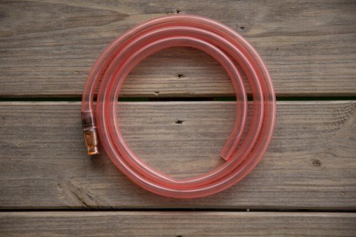

When i am on a job & running low on Diesel
I transfer fuel using a
Self-Priming Shaker Style Siphon Pump​
It is fairly stiff plastic hose
I have used one of these since 2004 & i think only once, it was caught for a bit.
A Harbor Freight look a like hose is too soft & flexes too much
