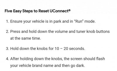

I have a RA2 in my truck, most resets I see are for an 8.4 not a 5.0 screen
But nonetheless I am open to anything, well just about anything:banana-mario:
