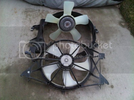

Mine stays at 185 all the time now. Used to run 215. I don't see an auxiliary fan for AC . Does my 2011 have one?
its under the ********* shroud, right up against the radiator
All 4G Ram V8's come with both a mechanical/clutch fan and an e-fan
