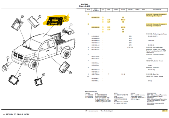

Just found this forum. I have the same issue! Question: Do you know the model EVIC you got with the horn-on unlock option? I see a lot listed on EBAY! Thanks!
I do know, unfortunately that knowledge will do you little good because it isn't compatible with your 2006 (PCI vs CAN). You need one of the p/n's below:
